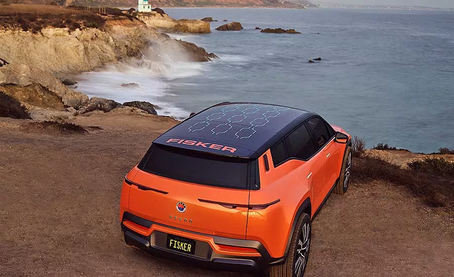

The new Fisker Ocean sport utility vehicle will feature a roof-mounted solar panel. Photo courtesy Fisker Inc.

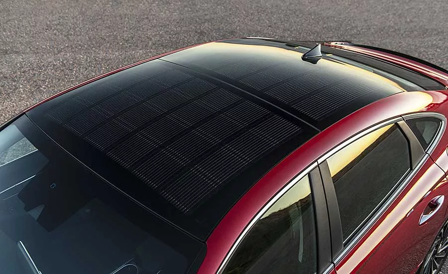

Solar panels can increase the distance that electric vehicles can travel. Photo courtesy Hyundai Motor Co.

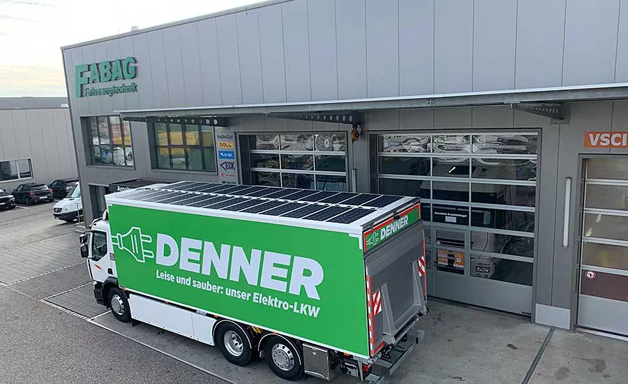

This electric truck is equipped with solar panels that provide power to a refrigeration unit. Photo courtesy Renault

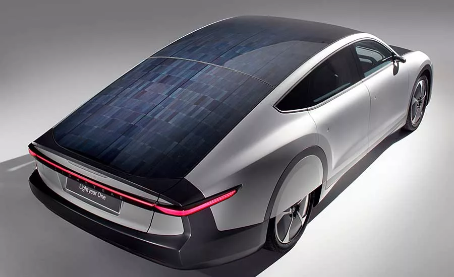

The Lightyear One will be equipped with 5 square meters of solar panels that cover its hood, roof and tailgate. Photo courtesy Lightyear One

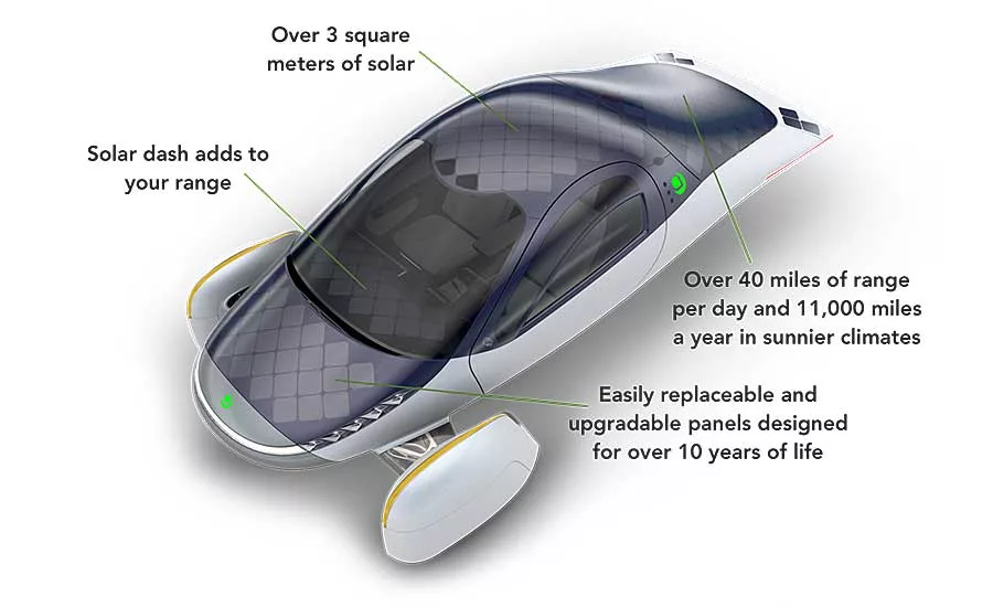

The carbon-fiber composite body of this vehicle will be covered in 3 square meters of solar cells. Illustration courtesy Aptera Motors Corp.

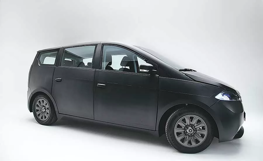

This EV will use proprietary technology that replaces traditional paint with integrated solar panels. Photo courtesy Sono Motors

Several start-ups, such as Aptera Motors, Atlis Motor Vehicles, Fisker Inc., Lightyear One and Sono Motors, as well as established OEMs like Hyundai, Tesla and Toyota, are developing solar cars or hybrid versions of them. They are integrating solar cells into roofs. However, other body parts, such as doors, hoods, tailgates and trunks, are also prime real estate.

As an example, Harrop points to Lightyear One, a Dutch company that plans to launch a “long-range solar electric vehicle designed to be grid independent” later this year. It will feature 5 square meters of integrated solar cells protected by double-curved and super-strong safety glass.
The solar roof will capture sunlight continually whether the car is moving or stationary. Lightyear One claims that feature will deliver enough energy to cover an average of more than 70 percent of annual mileage.
A conductive backsheet produced by Royal DSM is an integral element of Lightyear One’s solar roof. It enables all the connections of the solar cells to be put on the back of the solar panel, which makes every available centimeter on the front of the module available for capturing sunlight.
“The reduction in electrical (cell-to-module) losses not only delivers a 3 percent increase in power output; it has the added advantage of contributing to a more stylish sunroof with aesthetic appeal,” claims Pascal de Sain, vice president of DSM Advanced Solar.

“The benefit of solar-powered vehicles is that they don’t require fuel and have a low cost of maintenance,” says Lex Hoefsloot, CEO of Lightyear One. “Solar cars run longer on the same battery. This requires less charging stops and will get you faster from point A to point B. Solar energy will never run out and it is free.
“Because the pressure on the grid from solar cars is far less, they offer the potential to truly scale clean mobility,” explains Hoefsloot. “From a user perspective, all you need is a regular power outlet combined with the sun; no need to wait for charging infrastructure, again creating a scalable solution.”
Hoefsloot claims that Lightyear One will “consume two to three times less energy than any other electric vehicle on the market today, which results in an exceptional range of 725 kilometers.” However, the overall achievable yield strongly depends on the driving patterns of individuals.
“[Our vehicle] has around 1,000 individual solar cells across the car that ultimately add 50 to 70 kilometers of range per day during summer,” Hoefsloot points out. “[Our solar modules] can charge the car’s battery with up to 12 kilometers of range an hour. These solar cells are 20 percent more efficient than the solar panels you can buy for your home. And, they’re encased in safety glass to protect them from damage.

Several solar-powered cars are currently available, with others on the horizon. Last year, Hyundai Motor Co. unveiled a hybrid version of its popular Sonata sedan that is equipped with a roof-mounted system. It consists of a solar panel and controller that enable the vehicle to generate and store electricity in a battery.
According to Hyundai, the system can charge 30 percent to 60 percent of the battery per day, which can increase the vehicle’s travel distance by an extra 1,300 kilometers annually.

Later this year, Aptera Motors Corp. plans to begin mass-producing a three-wheeled solar vehicle at its factory in San Diego. Its carbon-fiber composite body will be covered in 3 square meters of solar cells. The company claims that at least 90 percent of the power produced by the solar panels will go toward propelling the vehicle.
“Integrated solar can be configured to provide up to 45 miles of range per day,” claims Chris Anthony, CEO of Aptera Motors. “[This will be the] first vehicle capable of meeting most daily driving needs using solar power alone.
“Our built-in solar array keeps the battery pack topped off,” explains Anthony. “Never Charge technology is built into every vehicle and is designed to harvest enough sunlight to travel over 11,000 miles per year in most regions.”
Sono Motors is a German start-up company that plans to ramp up production of its Sion vehicle in 2023 at a former Saab plant in Trollhättan, Sweden. Sono's proprietary technology replaces traditional paint with integrated solar panels.
“Solar modules are worked seamlessly into the surface of the body parts to supply vehicles with electricity,” says Mathieu Baudrit, director of photovoltaic integration at Sono Motors. “Drawing on the power of the sun, [our] system will be able to provide energy for an additional range of up to 245 kilometers a week.
“We have found a way to deliver sustainable, free power across various transportation applications by replacing the traditional paint shop process with integrated solar technology,” claims Baudrit. “[Our] solar technology is cheaper, lighter and much more efficient than conventional glass-based solar cells. With a boundless range of potential applications, [it] is a seamless, flexible solution for efficient electric charging.
"We wanted to develop a vehicle that can harvest the maximum amount of energy from the sun," explains Baudrit. "Current technologies available on the market are based on glass photovoltaics, only allowing solar cells to integrate on flat surfaces such as the roof. Having solar cells only on the roof will not harvest the maximum solar energy throughout the entire year, because the sun is lower in the sky during winter.
"We had to create a whole new manufacturing process to integrate the solar cells on the vehicle body, based on injection molding," says Baudrit. "Injection molding is a manufacturing process which allows us to make complex shaped parts out of polymers. It is a very fast manufacturing process, allowing low scrap rate and many different applications.
"[This enables us to] achieve a seamless integration of the photovoltaic function into the car body panels," adds Baudrit. "It is flexible in the sense that we can shape the PV function to the form of the host vehicle as robust as conventional polymer car body panels and cheaper. Thanks to the injection molding process, we remove the need for curved glass.
"We are planning to integrate more than 248 solar cells into the Sion, with a target of having 1.2 kWp of solar cells installed on the vehicle," Baudrit points out. "The solar panels are the body panels. The solar panels will be integrated into the hood, fenders, sides, roof and rear of the vehicle, visually blending into the surface."
